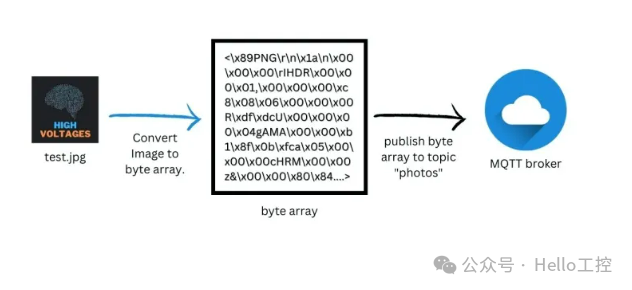

使用 MQTT 协议发布图像是一种非常直接的方法。下面的图像解释了我们在本期中将要使用的流程。
Step1:首先我们需要在 Python 中读取我们的图像文件或其他类型的文件。
with open("./test.jpg",'rb') as file:    filecontent = file.read()
Step2:读取文件后,我们将图片转换为字节数组。然后我们将字节数组发布到我们想要发送图片的主题。
    byteArr = bytearray(filecontent)
Step3:在这种情况下,我们使用以下代码将图片发送到名为 photos 的主题。
    result = client.publish(topic,byteArr,2)msg_status = result[0]if msg_status == 0:    print(f"message : Message sent to topic {topic}")else:    print(f"Failed to send message to topic {topic}")
字节数组将发布到主题。以下是一段完整的代码,它将帮助您使用 mqtt 协议在 python 编程语言中发布任何图片:
import timefrom paho.mqtt import client as mqtt_clientbroker = 'broker.hivemq.com'port = 1883topic = "photos"client_id = 'your client id'def connect_mqtt():    def on_connect(client, userdata, flags, rc):        if rc == 0:            print("Successfully connected to MQTT broker")        else:            print("Failed to connect, return code %d", rc)    client = mqtt_client.Client(client_id)    client.on_connect = on_connect    client.connect(broker, port)    return clientdef publish(client):    with open("./test.jpg",'rb') as file:        filecontent = file.read()        byteArr = bytearray(filecontent)        print(byteArr)        result = client.publish(topic,byteArr,2)    msg_status = result[0]    if msg_status == 0:        print(f"message sent to topic {topic}")    else:        print(f"Failed to send message to topic {topic}")def main():    client = connect_mqtt()    client.loop_start()    publish(client)    time.sleep(5)    client.loop_stop()if __name__ == '__main__':    main()
